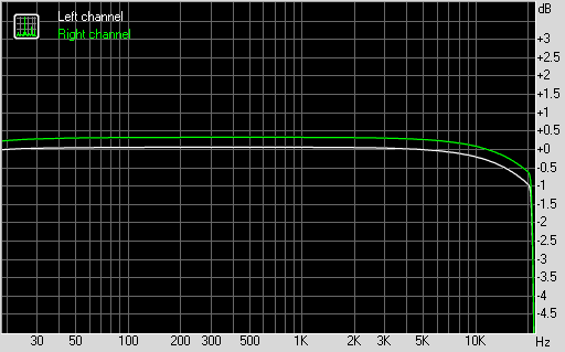

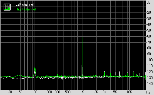

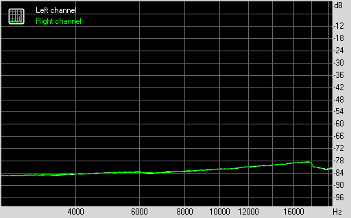

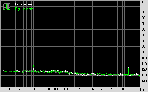

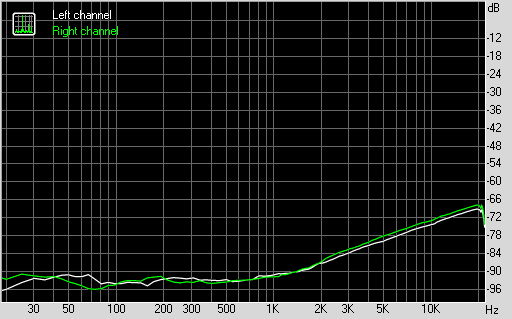

在小明那边晃了几天,将8并用小明的设备测试了下,专业数字声卡RME96/8,ADC用百灵达SRC2496
平衡输出测试数据如下:
RightMark Audio Analyzer test report
Testing deviceC-DREAM WM8740X8
Sampling mode16-bit, 44 kHz
Interface
Testing chainExternal loopback (line-out - line-in)
RMAA Version6.0.6
20 Hz - 20 kHz filterON
Normalize amplitudeON
Level change-0.2 dB / 0.1 dB
Mono modeOFF
Calibration singal, Hz1000
Polarity correct/correct
Summary
Frequency response (from 40 Hz to 15 kHz), dB
+0.06, -0.52
Good
Noise level, dB (A)
-95.3
Excellent
Dynamic range, dB (A)
96.0
Excellent
THD, %
0.0012
Excellent
THD + Noise, dB (A)
-87.9
Good
IMD + Noise, %
0.0048
Excellent
Stereo crosstalk, dB
-91.4
Excellent
IMD at 10 kHz, %
0.0084
Very good
General performance
Excellent
Frequency response
From 20 Hz to 20 kHz, dB
-0.93, +0.06
From 40 Hz to 15 kHz, dB
-0.52, +0.06
Noise level
Left
Right
RMS power, dB
-94.5
-94.0
RMS power (A-weighted), dB
-95.8
-94.9
Peak level, dB FS
-82.3
-82.4
DC offset, %
-0.0
-0.0
Dynamic range
Left
Right
Dynamic range, dB
+95.5
+94.7
Dynamic range (A-weighted), dB
+96.5
+95.5
DC offset, %
-0.00
-0.00
THD + Noise (at -3 dB FS)
Left
Right
THD, %
+0.0013
+0.0011
THD + Noise, %
+0.0041
+0.0041
THD + Noise (A-weighted), %
+0.0040
+0.0040
Intermodulation distortion
Left
Right
IMD + Noise, %
+0.0048
+0.0049
IMD + Noise (A-weighted), %
+0.0044
+0.0045
Stereo crosstalk
Left
Right
Crosstalk at 100 Hz, dB
-93
-93
Crosstalk at 1000 Hz, dB
-90
-91
Crosstalk at 10000 Hz, dB
-73
-72
IMD (swept tones)
Left
Right
IMD + Noise at 5000 Hz,
0.0066
0.0065
IMD + Noise at 10000 Hz,
0.0081
0.0080
IMD + Noise at 15000 Hz,
0.0104
0.0105
