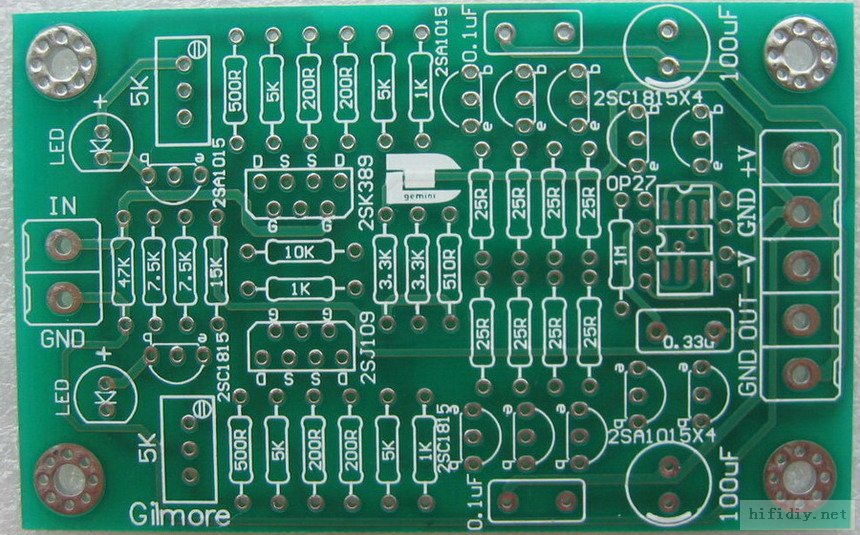

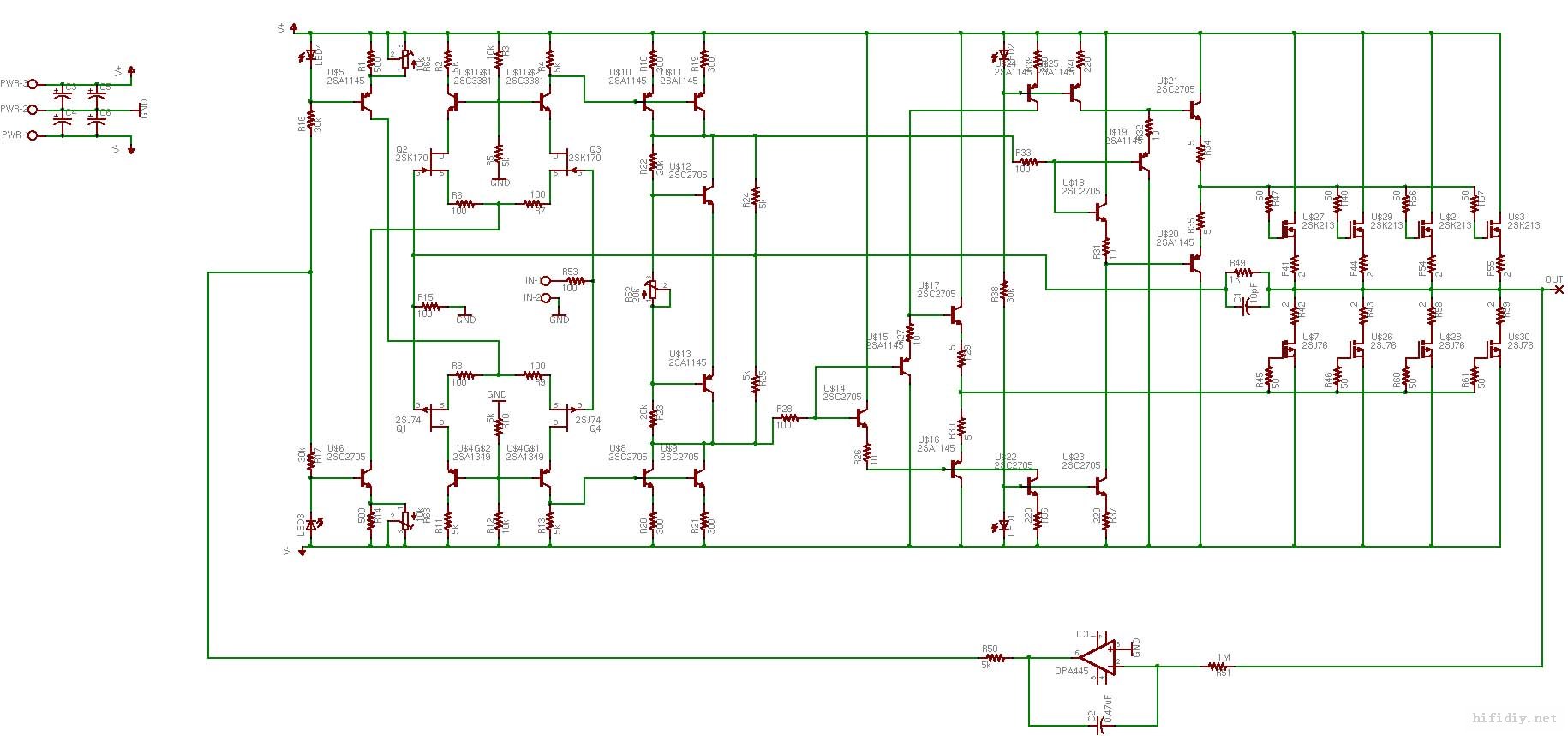

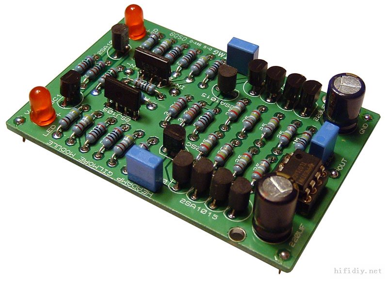

 楼主| 发表于 2008-12-15 22:24 | 显示全部楼层
原帖由 millwood 于 2008-12-15 21:01 发表
the KG amp is a sound and proven design. the biggest issues with it are a) limited range for the servo; and b) stability.
1) the original design requires very precisely matched transistors (
恩恩
这台我朋友做过
国内对这个耳房叫做小G
听过 解析力不够好
是他初期的作品
其实这些都不是Gilmore的代表之作
KG比较新的版本电路是dynagbffet
不过这个图有不少错误

 楼主| 发表于 2008-12-15 22:33 | 显示全部楼层
KG 年初公布的 dynagbffet
我已经做好了

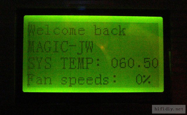

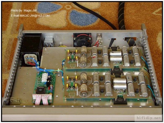

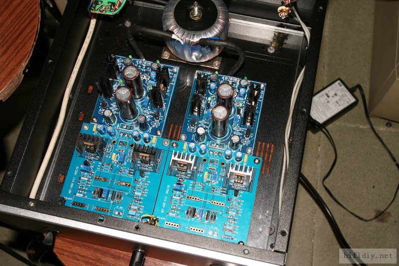

 楼主| 发表于 2008-12-15 22:38 | 显示全部楼层
当时兴致比较高
机壳虽然是全铝的
但是 输出四对管
对付 单管60MA电流 还是有点热
还加个了个MCU的温控散热系统
温度传感器是数字传感器 AD7416

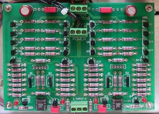

发表于 2008-12-15 22:46 | 显示全部楼层
这个是我做的,跟K.G不同的是输入为菱型差动,输出用mje15030/31,全电路没用CASCODE,全直藕也没直流伺服,算是简洁的全互补对称电路。

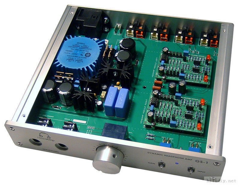

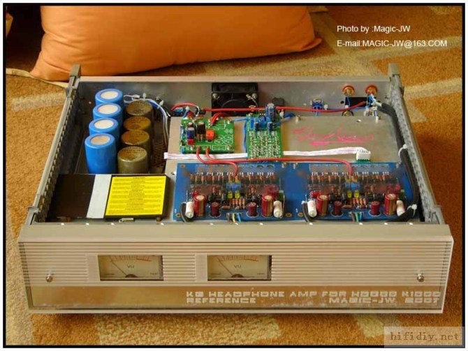

发表于 2008-12-15 23:19 | 显示全部楼层
原帖由 millwood 于 2008-12-15 20:31 发表
a better designed amp is the Gilmore headphone amp which can also be used to drive speaker phones too.
Other than the servo, it doesn't have many of the issues of b22.
这个电路我做过,声音过于清纯,密度和厚度要逊色一些。

发表于 2008-12-15 23:29 | 显示全部楼层
原帖由 燃烧我的罪恶 于 2008-12-15 22:24 发表
不过这个图有不少错误
that's a fairly interesting design: the use of resistors loading vs. constant current diodes in b22, the use of diamond buffers as drivers, the inclusion of gate stoppers on the mosfets, the trimmers on the constant current source, lower output resistor on the servo, etc. he addressed many of the complaints we had for the original gilmore amp and used the mosfets correctly.
in comparison, the b22 is more like a low-quality clone of the new gilmore amp.

发表于 2008-12-16 01:30 | 显示全部楼层
原机图
