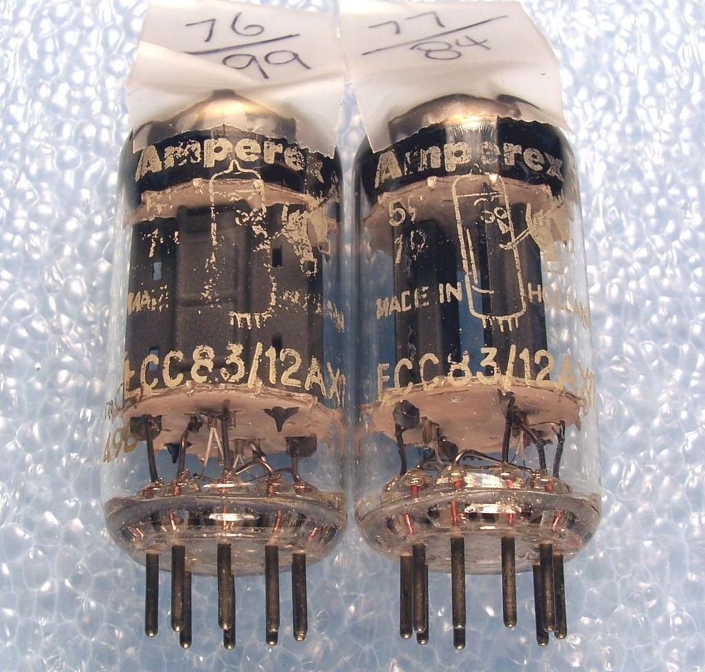

发表于 2015-4-27 11:47 | 显示全部楼层
備料到了選管, 因手上沒有這類管子. 所以跟猫版建議, 但算同廠不同年份有不同規格. 翻看了一兩次這M7論壇, 基本買了次級GE 5751和一級的東芝12AX7.
麻煩猫版看看照片是否可取? 另外第1級12ax7還有amperex bugle boy 比我買的東芝好嗎?
第3級有以下選擇: 1. Philips 6201,  2. Mullard M8162,  3. Mullard CV4202 那支好?
[img]%5BURL=http://s1160.photobucket.com/user/ck2007007/media/6x5751.jpg.html%5D[/URL][/img]
[img]%5BURL=http://s1160.photobucket.com/user/ck2007007/media/toshiba%2012ax7.jpg.html%5D[/URL][/img]
[img]%5BURL=http://s1160.photobucket.com/user/ck2007007/media/bugleboy%2012ax7.jpg.html%5D[/URL][/img]
[img]%5BURL=http://s1160.photobucket.com/user/ck2007007/media/philips%206201.jpg.html%5D[/URL][/img]
[img]%5BURL=http://s1160.photobucket.com/user/ck2007007/media/mullard%20cv4202.jpg.html%5D[/URL][/img]
[img]%5BURL=http://s1160.photobucket.com/user/ck2007007/media/4xCV4202.jpg.html%5D[/URL][/img]
731091
122
127 点
107 ¥
2014-7-27
